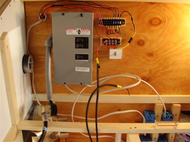

I went to Home Depot and bought a 30 amp plug and some heavy gauge 30 amp wet location wire. I wired the plug with the wire to the electrical box. Then I went to Walmart and bought the 30 amp extension cord (I think its 25 feet long (it was like $20). I run this cord through the service outlet in the teardrop and connect it to the plug in the electrical fuse box. The other side runs to shore power. When I am at home and need electrical service for something I use an adapter like those shown a couple posts above. They make two types. I use the one that connects into the electrical plug from the fuse box, but has a male 120V end to plug into the end of a regular 3 prong extension cord.

Postby dmckruit » Wed May 12, 2010 9:33 am
Buy a connector like this:
http://www.homedepot.com/h_d1/N-5yc1vZ1xil/R-100669948/h_d2/ProductDisplay?langId=-1&storeId=10051&catalogId=10053
and a small length of wire to hardwire this connector to the electrical box on the trailer.
Buy one of these extension cords:
http://www.adventurerv.net/amp-extension-cord-p-7098.html
and a cable hatch:
http://www.adventurerv.net/cable-hatch-p-7932.html
you should be able to find the last two at walmart.
I run 30 amp to the main fuse box. I have two 15 amp and one 20 amp breaker. The 20 amp runs the air conditioner and exhaust fan. One 15 amp runs the refrigerator and an extra outlet, the other 15 amp runs the tv outlet and battery charger. I haven't had a problem exceeding elecrical demand. (Of course I don't run every thing on the tear at once either). But I have had the refrigerator, air conditioner, exhaust fan, tv, and dvd player running at the same time without any problems.)
