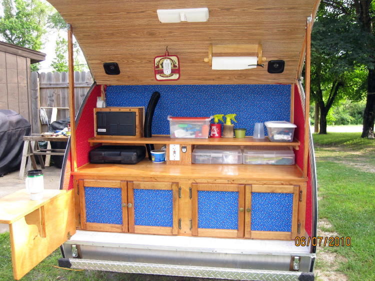

Yep, me too. Several of us here have used this one. I installed mine in 2006, & 12K+ miles later, no problems of any kind. Dunno if it has what they call a 'smart charger' but it keeps my battery charged when I have elect hookups, & provides 12vdc for stereo, all lighting, & 12v outlets whether using battery or 'shore' power. Has up to 5 (6?) 12vdc circuits & space for 4 115vac breakers. Wiring/hookup instructions that come with it ain't the best or clearest but it ain't that hard to do & enough here have done it that you can get pretty good help if needed :thumbsup: I placed mine in the galley right next to the shore power connection but you can put it nearly anywhere it'll be protected.
