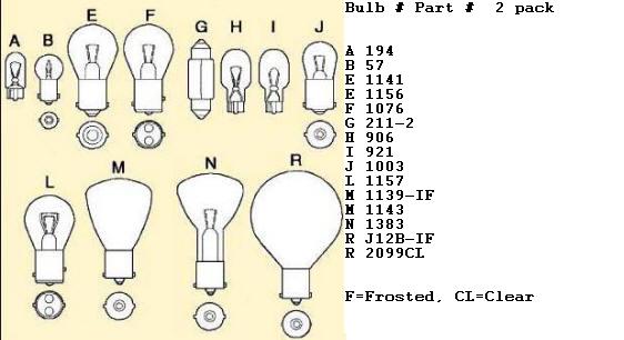

here is a chart of the more popular ones

Postby bobhenry » Mon Sep 13, 2010 8:59 am
So an 1157 taillight filiment draws .59 amps and
generates 3 mean spherical candle power or a 7
watt bulb ( about the same as a large clear
christmas light )
Step on the brake and you get 2.1 amp draw
generating 32 mscp or a 25 watt bulb
1156 is the same as 1157 with both filiments lit
the 921 bulb is 1.4 amp draw generating 21 mscp
at 16.8 watts
so the 921 is a close match to your 18 watt target
These bulbs are small and easily incorporated in an
unusual fixture or even incorporated with your AC fixture.
