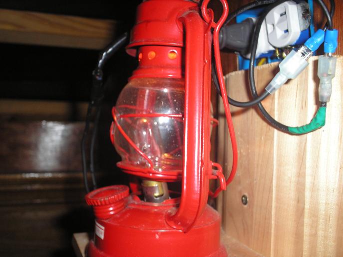

:lol: First you have almost everything you need now...An converter is AC to DC. If you get one you can make all your lighting 12vdc and don't forget the LED's. 8) I have a battery and one set of lights in the cabin that are 12vdc. The power switch panel ( http://www.basspro.com/Bass-Pro-Shops%C ... 62/-503579) has a 12 volt receptacle so I can charge stuff or run the computer... It also acts as a shut off. I have a cheap battery float charger.
And can add other lights as needed. I run AC florescents most of the time. Does that help?
