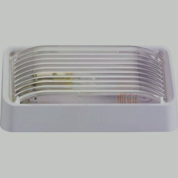

Can you take a standard 12v porch light like this:
and re-wire it with LED lights?
Wait...let me re-word that....can **I** take a standard porch light and rewire it to LED? My electrical experience is changing the plug on a lamp.
Any tips and hints as to how I can do it? Thanks in advance for your help.

Postby Nathan N » Thu Oct 28, 2010 5:33 pm
Lil,
Unless I'm missing something you could just change the bulb out for one of these:
http://www.pplmotorhomes.com/parts/rv-l ... -bulbs.htm
I ordered (don't recall if same outfit) a led bulb like one of the top ones and it fit into a similar fixture.
Nathan

Postby Ageless » Thu Oct 28, 2010 6:12 pm
If .you can solder; no need to spend $20. You can buy prewired 12V LEDs for about 14 cents each.

Postby Shadow Catcher » Thu Oct 28, 2010 6:17 pm
Absolutely you can. I had fixtures that had wedge bases, no problem and I used amber arrays (bug).
Postby mcspin50 » Fri Oct 29, 2010 6:57 pm
Thanks all for your responses guys. I'm a little less muddled on it.
Nathan, I was hoping to find a less expensive way to convert. It's tempting tho, since the solution is so simple. I keep looking for fixtures that are already LED but can't seem to find them in my price range...as in "cheep!"
Ageless, I did get LED lights like these (the same ones Zach used in a way cool method on the outside of his Scuttlebutt:
http://www.creativelightings.com/Waterproof-LED-Modules-LED-Pucks-s/1056.htm
Can I convert the ol' porch light to one of these? I'll go get a soldering iron and practice. :O
Shadow Catcher, I love your confidence in my abilities. Looked at your conversion pic in your album, and it doesn't look TOO hard.
The lights I got said they had to be wired in parallel. Can someone explain what that means? :thinking:
Thanks for your patience as I ask so many dumb questions. :scratchthinking:

Postby Ageless » Fri Oct 29, 2010 7:09 pm
Wired in parallel: connect all positive leads together, all ground leads together. BTW LEDs will only operate with correct polarity unlike incandescants

Postby S. Heisley » Sun Oct 31, 2010 10:10 pm
Using Bruce's (bdosborn) supplied website, I found this LED bulb that replaces the bulb in your existing porch light fixture without having to rewire!
http://www.ledtrailerlights.com/rv/RV-1141.htm
I state the above based on my Gustafson porch light, which uses bulb #1003 and looks identical to the one in your picture. While they cost a lot more than a traditional incandescent bulb, they are supposed last 10 years or more.
