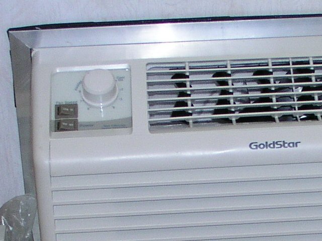

Does anyone know how to add a thermostadt to one of those cheap manual air conditioners? I installed a cheapie in my TTT, but I don't want to turn it into a meat locker.
Here's the one that I have...
Any ideas?

Mike, that is a thermostat, isn't it?
You have off/on....... hi/lo..... and a dial thermostat...

Postby mikeschn » Mon Jul 11, 2005 6:12 am
I'd prefer something more like I have here in the house. Set it to 75 and forget about it!!! Has anyone done anything like that on a 5000 btu window unit?
Postby asianflava » Mon Jul 11, 2005 6:26 am
Take off the inside filter and you'll see a copper tube stuck to the evaporator coils with plastic clamps. That is the "probe" for your thermostat. It is sampling the air coming into the evaporator, when it gets cold enough it will shut off the compressor.

Postby mexican tear » Mon Jul 11, 2005 8:59 am
It is easy to add a remote thermostat to your A/C.
Cheep thermostat, there is a teardrop shaped one at Home Depot for 39 dollars. 12VDCrelay capable of switching sufficient starting current and then just switch the plug tht the A/C is plugged intowith the relay. I have used this meathod in numerous applications over the years and still use it on my Petcool inthe Mexican Tear.
Go to an electrical store and get a small moter starter to do the job. The Petcool is small enough that I can use a reular lug in relay. Check out what the starting current is and go from there.
I can e-mail you a diagram of what I usualy do if you need it.
good luck
