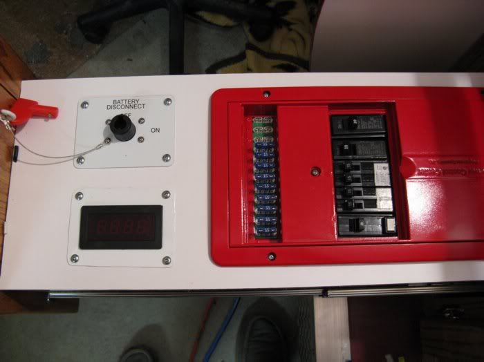

Postby planovet » Fri Feb 25, 2011 12:56 pm
Everybody does it differently.
I had a power center with places for twelve 12V fuses so I used most of them. One fuse for the two porch lights, one fuse for the two reading lights, one fuse for the fan, one fuse for the galley light and so on. I then used appropriate fuses for each one, from 15 amp to 5 amp (the picture below shows all 15 amp fuses during install).
Since all my wires are buried where it would be impossible to get to if one went out, this method allows for one circuit to be fried and most of the lights will still work.
Not a perfect system but it works for me.
