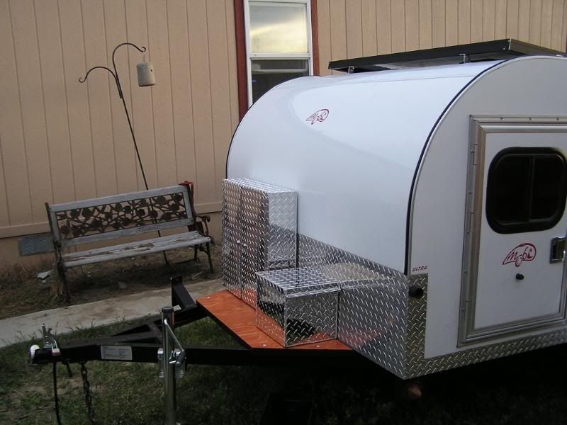

There is nothing wrong with being a rookie especially if you keep asking questions you will be an expert before you know it. Here is my set up:
Yes, I doubled up some 3/4 in plywood and bolted it to my frame. I also stained and under coated it. (I was really intrigued by the whole woody concept and wanted to see what it would do). My Battery box and cabinet were purchased on eBay.
I have a gauge in the cabinet that is linked to my solar charger. An easy way to do it is get a gauge that you plug into the outlet. If you charge the battery when you get home and make sure that it is charged when you leave then you should be fine. I was able to run my battery four nights just using my CPAP and no charger so you should be OK with just a couple of night running just your CPAP.
