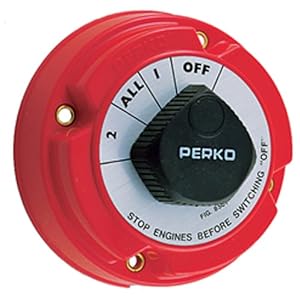

When referring to my wiring diagram below for my new teardrop, I have a question regarding the Perko 8501 Marine Battery Selector Switch
If I were to replace the SPDT switch (between the batteries and the WFCO) with this Perko switch, would the following knob positions result in:
1) Power the trailer from just the tow vehicle battery
2) Power the trailer from just the RV battery
ALL) Connect both batteries in parallel to power the trailer, also resulting in being able to charge the RV battery while towing
OFF) Disconnect all batteries from each other and the trailer

yep, thats what it would do.

Thanks Bruce. I remember looking into that before. I may eventually add one to my new teardrop, but the nice thing about the battery selector is that it relatively cheap, and will act as a full disconnect for both batteries.

The battery selector switch will also disconnect the on-board battery for storage too. Guess I could just disconnect at the battery terminal, but the switch gives it a "hint" of "professionalism" :lol:
