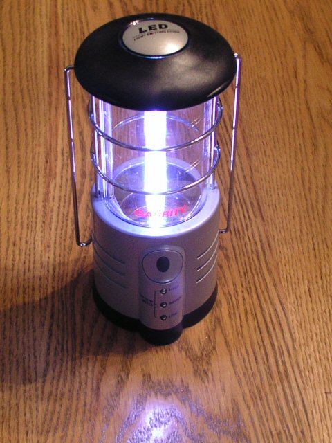

Postby mikeschn » Sat Aug 20, 2005 8:04 pm
If all you are going to run is lights... why not just get one of those led lanterns, pop a couple batteries in it, and volia', light... and LED lasts a long time compared to incandescent bulbs...
Not to put a damper on your 12 v battery, but there's other ways to skin the cat...
Here's another...
