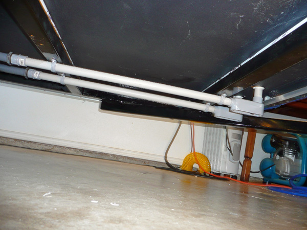

Postby aggie79 » Mon Dec 05, 2011 5:26 pm
Robbie,
I did as Wolfscout said. I used conduit and sealtight to run power from front of the teardrop to the back.
It is probably overkill, but my teardrop sits low - there's about 10" from the ground to the bottom of the conduit at the low point. I am also carrying several circuits in the two runs -DC in one and AC in the other.
I think you would be okay with using an extension cord (3-wire) but I would probably sleeve it in that lightweight flexible blue conduit as a precaution.

Postby aggie79 » Mon Dec 05, 2011 5:28 pm
Robbie,
You and I must have been posting at the same time. If you're wiring is going to be tucked up and covered as you said, that should be more than adequate for protection.
