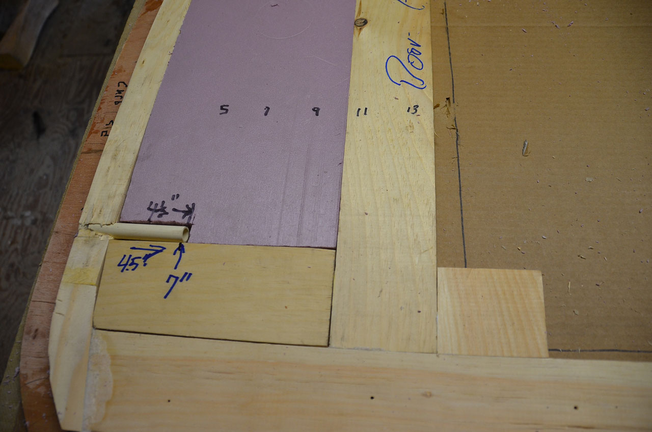

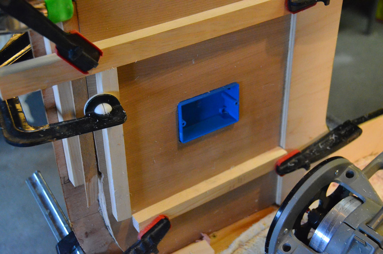

Yesterday, I routed out 1" depth where the box should go, and all went well. It even was in the right spot where I'd run a "conduit" in my foam wall! Imagine that!
The pictures I took with measurements marked along the way really worked.
So that's where I put the box:
It protrudes a 1/4" like bobhenry says, but I'll do a shallower version of Zach's and put a little ply maple frame around it that will match the door frame that you can see to the right of the box.
