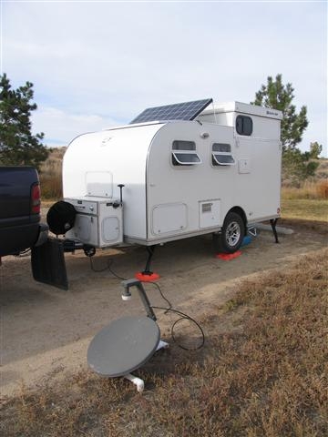

Satellite dishes on houses are grounded to provide a low impedance path to ground for lightning strikes. Its not really an issue in a teardrop setting as the dish isn't usually mounted on the trailer. Besides, you've probably got bigger problems than an ungrounded dish if lightning is striking that close to your trailer! :rainy:
Here's a picture of my dish:
