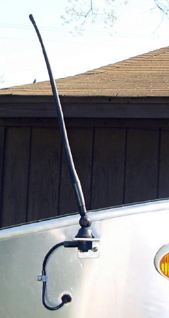

I had one of these on Compass Rose, it was snapped off in the accident :roll:

Shadow Catcher wrote:I had one of these on Compass Rose, it was snapped off in the accident :roll:
That's the one I was really looking for to suggest....
