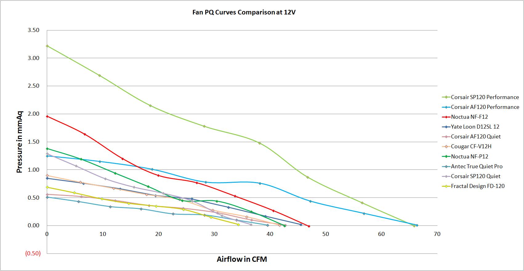

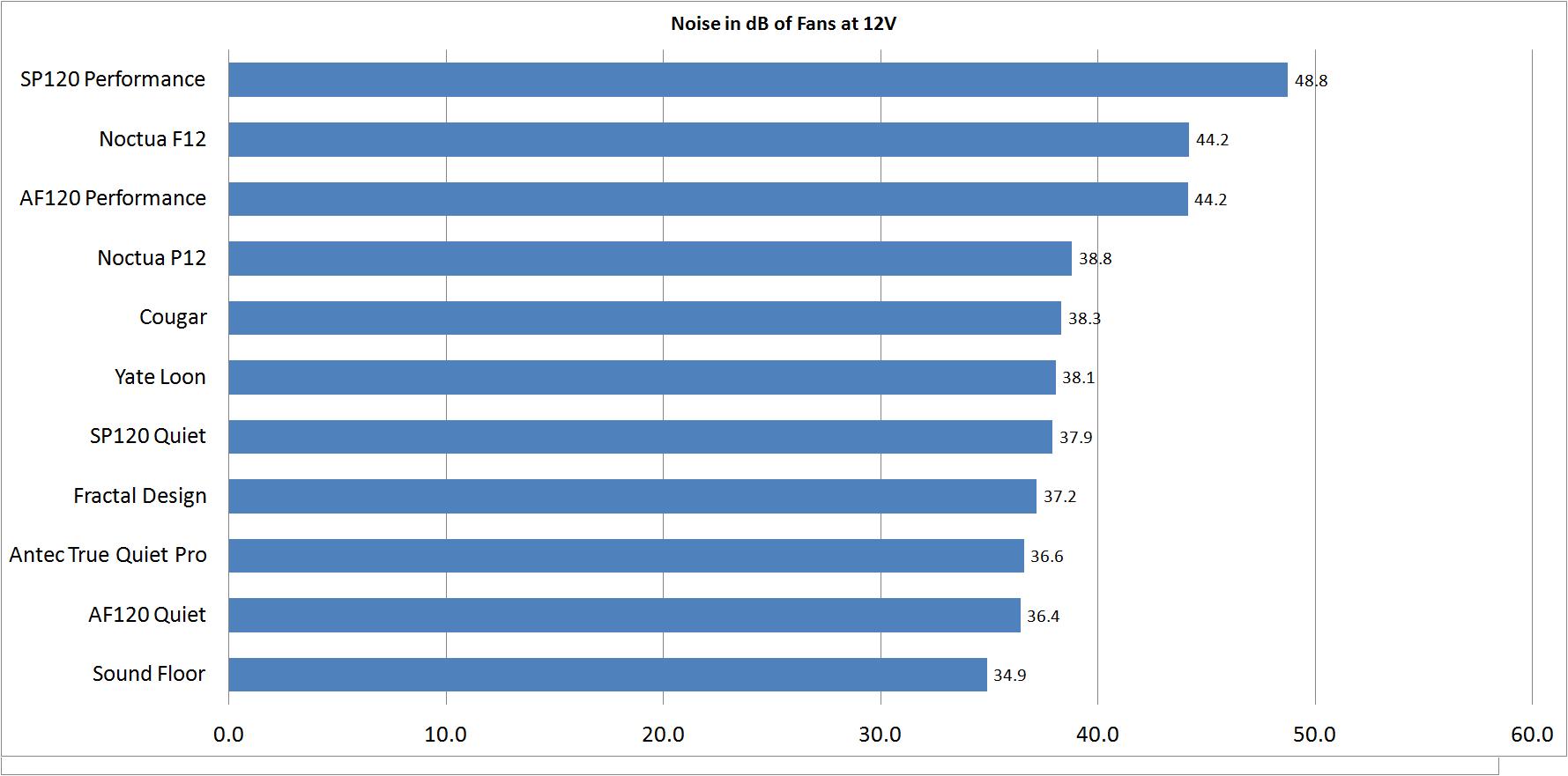

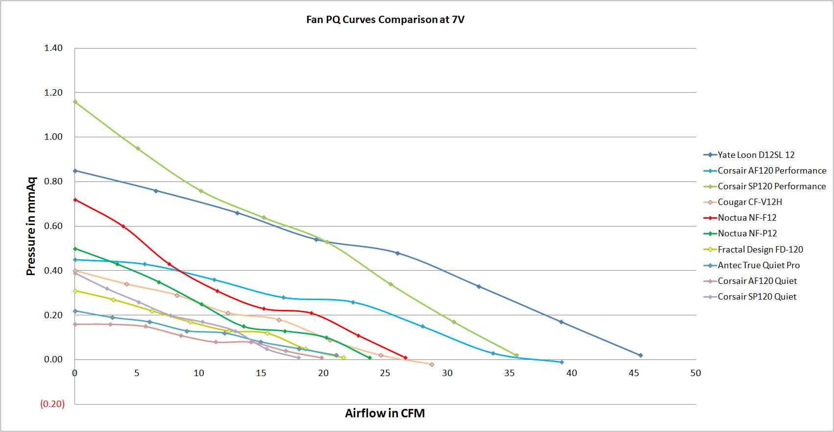

Of course, it makes a difference in what one considers quiet or noisy http://www.makeitlouder.com/Decibel%20Level%20Chart.txt. I am going to use two high static pressure performance Corsair SP-120 fans 96741 set up to blow out thru screened butterfly vents (2) 9698596987, full-time, when my trailer is stored (in my unsealed garage/shed that has lots of dust and insects year round). I want to create negative pressure in the trailer to keep out dust, insects, and mold by doing so. The fans will be hinged to the wall and can be swung in and out of position, used in tandem, at full or half speed (an in-line adapter with resistor can be plugged in to go 1/2 speed). When camping, the fans will not be needed, as a Honeywell fan http://www.homedepot.com/h_d1/N-5yc1v/R-202182997/h_d2/ProductDisplay?catalogId=10053&langId=-1&keyword=honeywell+fans&storeId=10051will be used and the computer fans will be off and swung away from the opened vents, and/or with opened windows. I am also considering this fan http://www.skycraftsurplus.com/12vdcfan235cfmcomairrotron.aspx as a 12vdc alternative (and I don't mind a few decbels, now and then). As further info, here are some charts I found that compare various fans and cfm airflow, that I basd my choice of the Corsair fans mentioned above:
Fan Noise at 12V.jpg (118.74 KiB) Viewed 2467 times
7V PQ Curves.jpg (113.6 KiB) Viewed 2467 times
