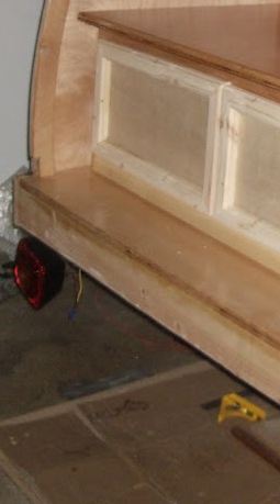

Postby pohukai » Thu Oct 04, 2012 8:42 am
In order to save my shins while walking around the camper at night, I'm thinking of mounting the tail lights under the frame or recessing them in the bumper. I'd like to use what I have as far as lights, which would mean mounting them under the frame. I'm not sure if 10" of clearance is enough here in So. Calif while in-tow. At least where I live, there aren't many deep gullies but I don't plan to camp in my 'hood'. How much clearance is really needed?

pohukai wrote:In order to save my shins while walking around the camper at night, I'm thinking of mounting the tail lights under the frame or recessing them in the bumper. I'd like to use what I have as far as lights, which would mean mounting them under the frame. I'm not sure if 10" of clearance is enough here in So. Calif while in-tow. At least where I live, there aren't many deep gullies but I don't plan to camp in my 'hood'. How much clearance is really needed?
One tip that I found when I went to install my stabilizer jacks, was to stretch a string from the bottom of the wheel to the bottom of the rear frame. Anything extending below that is likely to get scraped off when going up a steep incline or a speed bump(same idea applies to the front). The light mounted below the frame in the picture looks to be a likely candidate.
Like others have mentioned, follow the NHTSA guidelines to keep youself out of hot water with the local gendarmerie.
