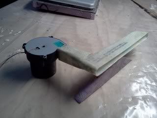

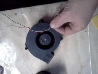

Postby Wobbly Wheels » Mon Dec 31, 2012 9:06 pm
I haven't done the furnace mod, but I've replaced squirrel cage fans with PC fans in heat exchangers in older boats built when PC fans weren't available. As long as there's enough airflow, they don't care where it comes from....so far, anyway :)
It might take some tinkering with a few fans to work out to be able to reduce a PC fan's output (square inches). When I've tried to install bigger fans (more CFMs) than what was installed, the fan speeds up - I assume the blade is cavitating from pressure because the air can't get out fast enough. That was going ridiculously oversize from what was there originally though....
I'm using the 12V squirrel cage to duct in fresh, cool air from under the trailer. It's just a vent fan.
It has a ~1 1/2" square output, so you would be enlarging it to mate with a 3"square (IIRC) inlet on the furnace.
This is my salvaged 12V fan and the diffuser that will go into the galley cabinet. The pipe it's sitting on is a scrap of 3" ABS just for fitting.
