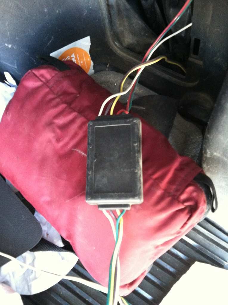

Postby nevadatear » Sun Mar 24, 2013 12:56 pm
So here is our four wire. I assume this is the ome converter? Five wires in and 4 out? Grounds included? Cut this out and replace?
