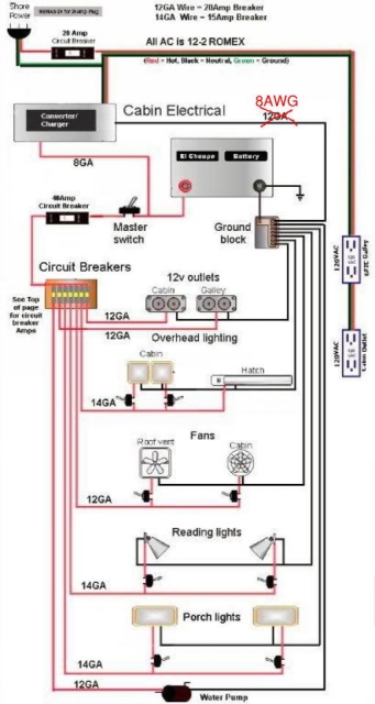

bdosborn wrote:Image
Electrical Linky
On that cabin electrical diagram. I notice the positive (+) wire from the converter to the battery is 8AWG, the negative (-) wire from the converter to the battery also needs to be 8 AWG too, not 12 AWG. The current supplied by the converter needs a proper return path back to the converter. Don't rely on the ground path through the frame being good. With 40 Amps going to the circuit breaker panel, then it also needs an 8 AWG wire from the battery to it. Same goes for the ground block.
For those 8 AWG wires it may be easiest to get generic battery terminal wires with the eyelet ends already on them. It will depend on what type of termination the devices like the cutoff switch and fuse block has. Using pre made generic battery terminal wires may mean getting 4AWG is easier, but over sizing only means extra weight and cost and these are likely to be short wires.
If your battery has stud posts, then wires with eyelets will be easier to use. Note: They generally use slightly different sizes for the eyelets on positive and negative wires. 3/8" is standard for positive and 5/6" is standard for negative. With the old style car battery post, get military style battery terminal clamps and then you can use wires with eyelets on the ends.

Postby bdosborn » Thu May 02, 2013 1:22 pm
Yeah, I saw that after I posted it. Embarrassed I missed that in 2005 and I wondered if anyone would catch it.
