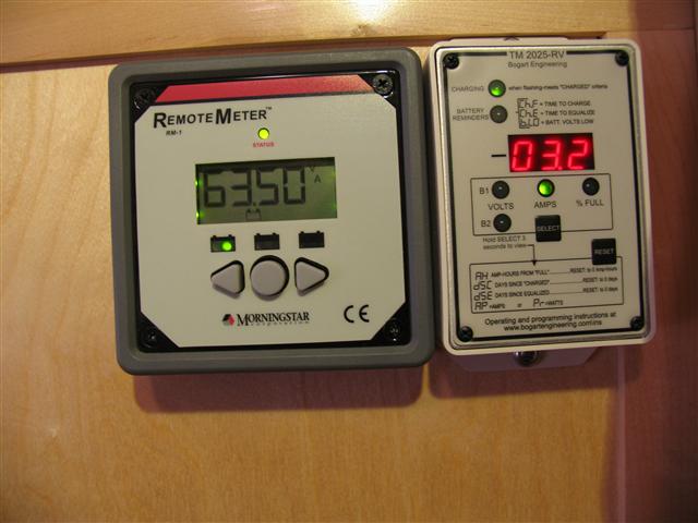

Yeah, the Susnsaver MPPT controller will limit its output to 15A. You could potentially waste 50 watts but I doubt you'd get the full output with the panel very often, especially if it stays flat. I've pegged my Sunsaver MPPT once or twice but it took 300 watts of panels (220 on the roof + an 80 watt portable) to do it.
P.S. I have the Morningstar remote meter hooked up to my controller, that's how I know I don't reach the controller maximum very often and never with the 220 watts laying flat.
