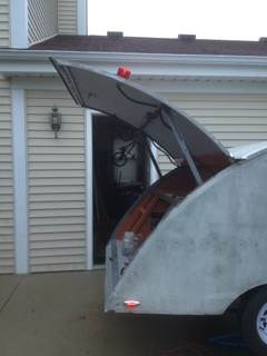

Okay, again, a very big newbee especially with electrical.
I'm following Desert Dawg's electrical diagram for my trailer. She has integrated running lights on the rear of her trailer, I have separate amber and red lights on the side. I have connected the running lights to the brown wire as she has shown (my light fixture has red and black wires.) I connected the brown wire from the trailer to the red wire of the light. The black wire is connected to the right and left front marker lights and then grounded to the frame.
My trailer is in my back yard and I cannot test it without dragging it out to the road; I was going to wait until I had the front and back running lights wired to drag it out, but it's raining so I had to come in and ask for help.
If I follow Joanne's diagram and again connect the red wire on the back marker lights to the brown wire from the trailer and again the black wire to a ground, as above, should everything be okay?
Thank you many times in advance.

Postby burlesot » Tue May 28, 2013 7:16 pm
I tested it out.
Several interesting observations:
1. My battery charger would not make the lights light. I did use the battery and found some interesting results.
2. With the white and brown wires connected to the battery, only the left tail light and left red marker lights worked.
3. With all for wires connected, both tail lights and the red marker lights lit.
Any suggestions?

Postby burlesot » Wed May 29, 2013 7:40 am
Dale,
Not sure the amperage on the charger.
My amber lights are in the front.
Yes, the brown wire, the same brown wire, is extended to all four running lights.
Seems strange the the back lights will light up when the same wire is extended from the front lights to the back. It would seem that if the front lights were not properly connected that the back lights would not work either, right?
I guess I'll pull the connectors off of the front marker lights and try again; I may try soldering the connections this time. I didn't do that last time because it is over my face/head when I'm under the teardrop doing it. Do you have any tips on the best way to make the connections? I've used waterproof butt joint connectors and those two to one trailer light connectors. Obviously those are not working as planned.
Have I mentioned how much I don't like these darn wires?
Grrr.
Thanks for your advice.
Todd
