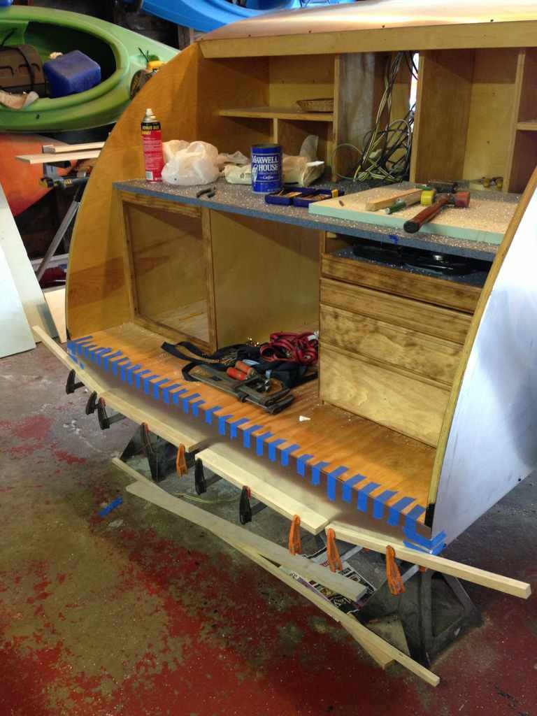

Okay....I'll try to describe. In the galley area, I have one cabinet on the left, one on the right, and a center "control panel" which has a car stereo installed. I would like to place a car fm antenna behind that panel but am getting very little signal. I really hate the idea of drilling a hole on the side of the trailer for the antenna. Any ideas? :roll:

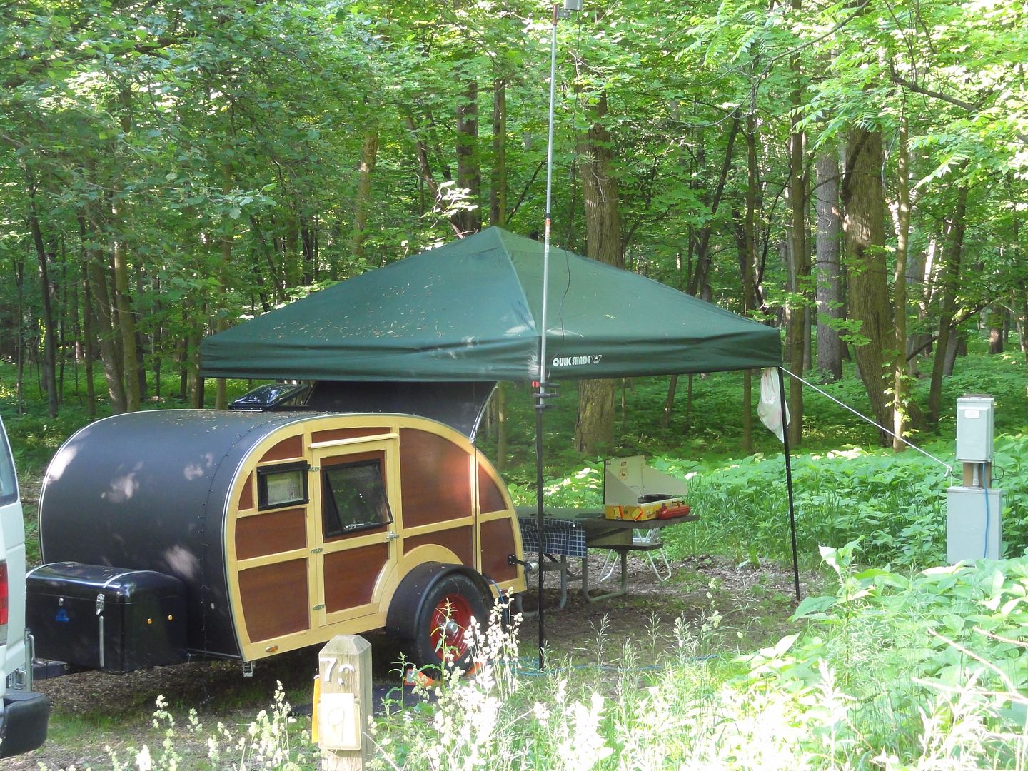

I don't have an FM radio, but I do have a TV antenna. I ran a coaxial cable to the bottom of the trailer, just sticking out enough to attach another coaxial cable to it when I set up. My antenna is attached to an extended painters pole that I clamp to my shelter leg. Works great. Can't see why you could not do the same.
Not the best picture but The pole is clamped to the shelter and extends up about 8 feet. The coaxial connection is just behind the fender.

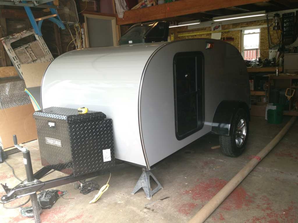

And it is wood, with an aluminum skin...you think the marine antenna will still work?
