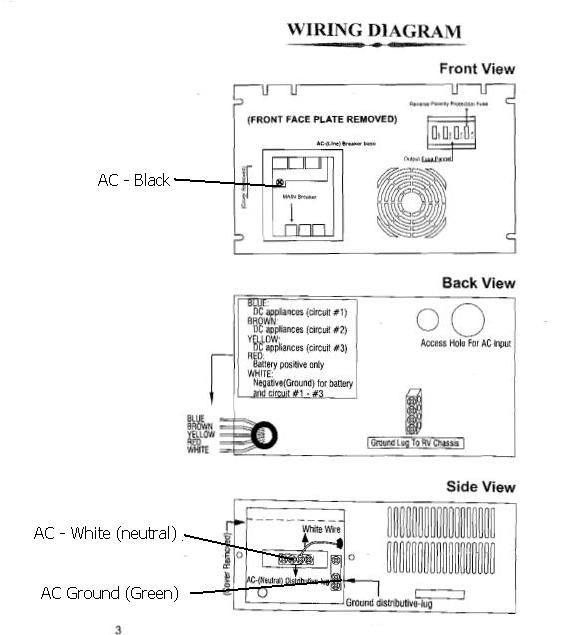

Here is pIc of how I interpret the AC hookup.... NOT SURE IF THIS IS CORRECT.....
From the really vague pictures and text in instructions its not really clear how the input side wiring is done...Uses EXTREME CAUTION...

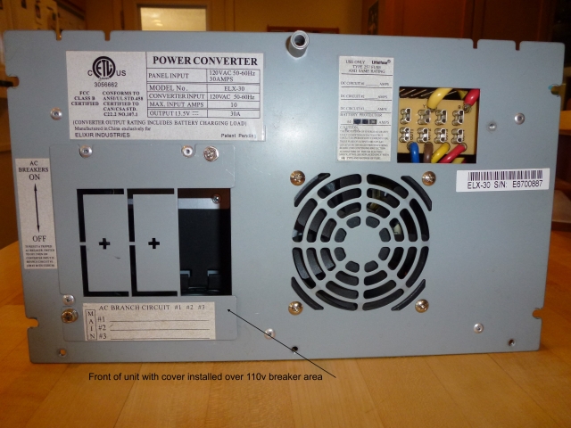

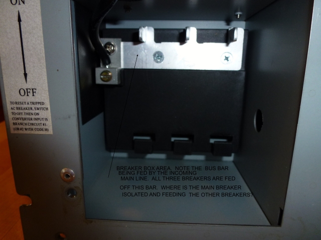

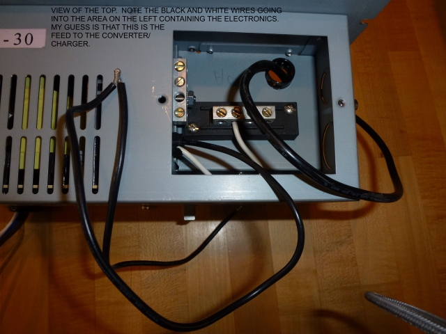

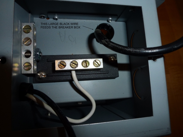

Here are some pics of the ELX-30.
It really is not clear in this picture, but the smaller black wire going into the electronics area is pig tailed for some reason.
So here is what I am thinking: from the incoming shore line, attache the black wire to the breaker bus bar, attach the white wire to the white wire lug bar, and attach the green wire to the green (ground) lug bar.
Put my first breaker (15 amp) in the first slot on the left. Out of it, I will attach the small black wire feeding into the electronics area (with the pig tail removed). This will allow me to isolate the converter/charger feed. Place other 15 amp breakers in the other 2 slots to feed my 110v receptacles I will have in the camper. Make sense?

Postby Dale M. » Sat Jun 22, 2013 10:23 am
I think you have a handle on it... Pictures seem to validate the sketch in instructions and your deductions.... Connect it up, power it up and verify everything with meter to be sure you have no stray voltages and you should be good...
I think what is a little deceiving is the label of "MAIN" I wanted to believe on first look they were referring to a main breaker at first look at instruction sheet ... Upon seeing your pics and reflecting on instructions, "MAIN" refers to "power in main" (hot lead) for 120C supply to breakers, and converter power...

Postby tonyj » Sat Jun 22, 2013 10:35 am
I am NOT an electrician.
I know nothing about this box other than what you have posted.
That being said . . .
I don't think you have a "main" breaker here. Looks to me it is set up for the shore power feed (the plug you plug into at the camping spot) which usually has a 15 or 30 amp breaker, to act as the main breaker. The shore power feed connects to the input feed plug you you install on the side of your trailer. The black power feed from that plug connects to the black input feed on your box, and it feeds the bar that the 3 breakers connect to. That bus bar with the black wire will NOT be de-energized just because the first breaker on the left is swiched off. There is no circuit isolation that on that "main" breaker that i can see. I really think this box should be looked at as a sub-panel that does not have an isolation main breaker.
