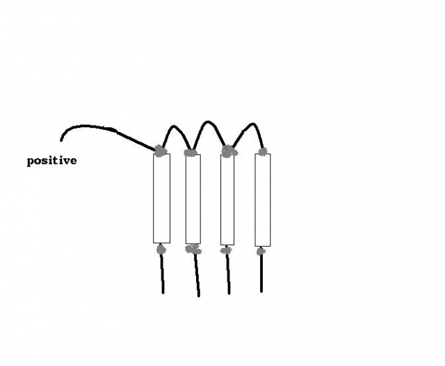

Here is Joanne's pictorial again. Look at the red (hot/positive) side the delivery wire is fused right at the battery and a disconnect then it traveles to a fuse block where it is downsized and routed to its final destination with each circuit fuse protected seperatly. A little hint I placed 4 fuses and each serves a different wall so if one is blown I know if its the right side the left side the front nose wall or in the galley wall.
OH ! here is a second vote for electronic's rosin core solder :thumbsup:
Here is the rather cheap and dirty 12 volt wiring on Chubby. The round black thing to the far left is a circuit breaker and manual shutoff in one ( Advance auto about $9.00) You see a 10 gage red enterin the bottom and out the top to the fuse block where it is distributed to the 4 circuits thru the glass fuses and out to the 4 walls of 12 volt demand. The negative from the battery run to the grounding block on the left and 4 return circuit legs match up with the 4 delivery circuts to return the circuit to the battery.

Thanks for posting the diagram again... What I was getting at is, "How do you split the one wire coming out of the fuse block to go to, say, the lights into two (or more!) wires to run each light?"

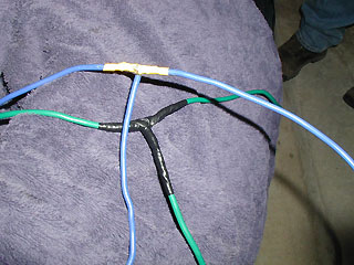

Here is what you are having trouble seeing in the picture I split the single feed wire into 4 circuits. the silver is a soldered joint. You can make multiple hookups on each of those 4 circuits by simply continuing the feed wire to all points needed. I simply removed a bit of the insulation and soldered a bell type splice (wrap a feed wire around the bared spot on the continuious feed wire and solder on a short feed wire and insulate) and took that short feed wire where needed.
found a pic of a tee style splice
