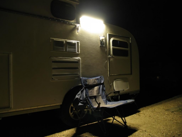

I converted my porch lights to LED and then wired them so that I can turn them all on with a switch inside the cabin:
I also wired them so that the switch at each light turns them all on as well. Very handy when you're camping by yourself and things go bump in the night. :frightened: Then I added a remote relay that I can turn them on and off with a wireless key fob but that might be just a little over the top. :lol:
For outdoor reading on a balmy night, I have a removable LED light bar that hangs off the corner trim.

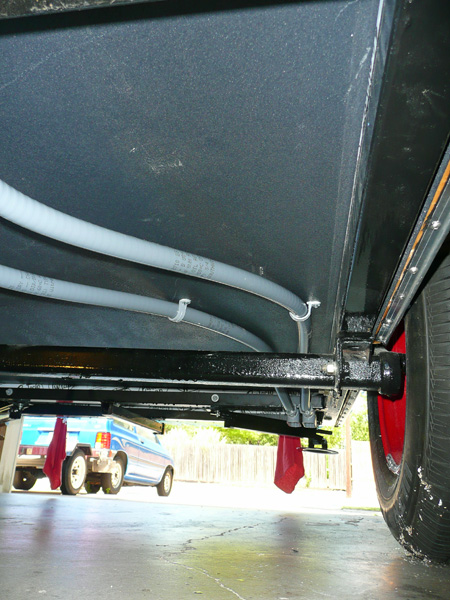

Battery location is a matter of tongue weight and trailer balance. My battery weighs 60# or so. I had planned for it on the tongue, but that made the tongue weight excessive. I moved it to the galley.
I used a wire size hole and blob of silicone adhesive for all wall and floor penetrations for the wire.
