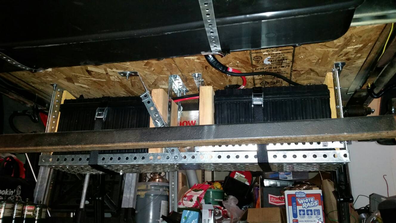

Postby Epbowen » Wed Jul 09, 2014 11:27 pm
Do to space and weight considerations I put my two batteries here. This puts the weight behind my axel.
