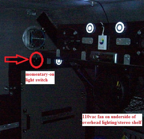

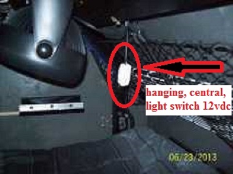

Probably not like my function over form set-up, but here it is: I put a switch hanging in the front/center of my cabin, easily reached from either door.
It is connected to the overhead set of 12vdc LEDs, which are "always" connected to the battery (bypassing the interior cut-off, but not the master). Never have to hunt for a light. I also have exterior/waterproof LED strip lighting (on the frame under each door), also 12vdc, with momentary-on switches ((mounted above each door), to light the ground before one steps out at night (don't like stepping on reptiles...)
