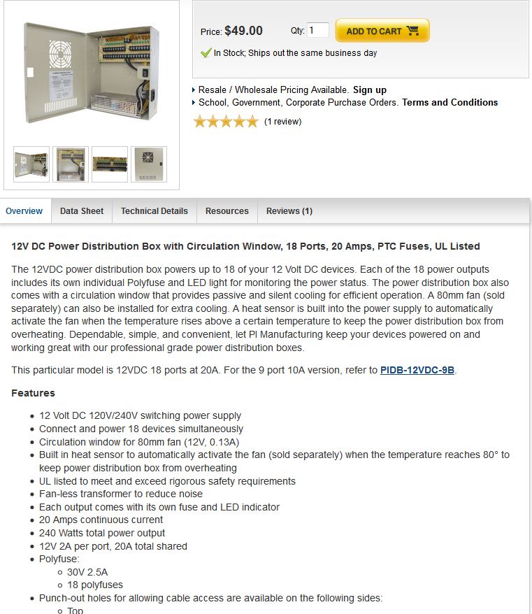

I am still working on my plans for my trailer and I would like to get some input on the 12v DC power.
Please look at the image attached and let me know your opinions.
Thank you.
Joe

It would seem it will power up to 20 amps in output, but relys on unit being powered by 120v ac source... May be fine if you always have 120v ac available to power unit, but if you Do not have "shore power" you will have nothing...
Did not see any place to connect large reserve battery, but I did not go that deep into specifications...
Dale

It appears the max output per "port" is two amps. That wouldn't meet my needs. Will it meet your needs?
You could "double up" on the output ports to get more capacity on a circuit but then the number of circuits would be limited.
I think I'd spend the money and get a Progressive Dynamics charger/converter which will supply more current in general, more current per circuit, and properly charge a battery should you install a battery (which IMHO is a good thing to have).
If you don't have the money, sell your wife or one or more of your kids if need be. I, however, am not in the market for either.

Seems like an incredible amount of overkill. A fuse block from Hella is $8 and some basic wiring will do very nicely. Space is a much bigger issue that I ever thought it would be. I'll forget about something that big and look at something like this: http://www.amazon.com/HELLA-H84960111-8 ... fuse+block

20 Amps is not a lot of DC Current at 12V. Typically you would want to distribute the 12VDC from your Deep Cycle battery and buy a Converter/Charger to keep the battery up with 115VAC or you could buy a Solar Charger. Everything depends on what your plans are, but I'd think a simpler terminal strip would be fine and inline fuses to protect your wiring. In my opinion, this box would be a waste of $49.00 for a camper. Sorry to be negative.

flboy wrote:20 Amps is not a lot of DC Current at 12V. Typically you would want to distribute the 12VDC from your Deep Cycle battery and buy a Converter/Charger to keep the battery up with 115VAC or you could buy a Solar Charger. Everything depends on what your plans are, but I'd think a simpler terminal strip would be fine and inline fuses to protect your wiring. In my opinion, this box would be a waste of $49.00 for a camper. Sorry to be negative.
Well said, I hope I didn't come across as negative. Especially when dealing with power, I try to remain positive :D.
Bee sure you fuse whatever you do...it's amazing how much juice is in a battery....one short of the terminals and the related shower of sparks will give you that insight.
We wound up buying our camper just because of time and ambition being in short supply, and after 3 years I've learned that a lot of these kinds of gadgets we were planning aren't necessary....there is so little space, and it's very easy to keeping adding "just one more" thing to find you don't have space for true necessities. Devices like this are for 36 foot class Cs, and it's easy to start thinking like an RVer....teardrops aren't RVs. They really are steps up from a tent....and you need to think with that mentality...not like an RV.
My rule....Small is good, light is best...and no single tasking devices except the fire extinguisher.

I appreciate all your comments. They all do make very good sense. I will look into other options and let you all know. I am excited about my build. I will have a deep cycle marine battery or two for wilderness camping but will mainly be campground camping. I am also looking at built in Air conditioner when we are on AC current.
I can do 120V wiring all day long. but the DC convertion was giving me fits. Thanks again everyone I appreciate it.
