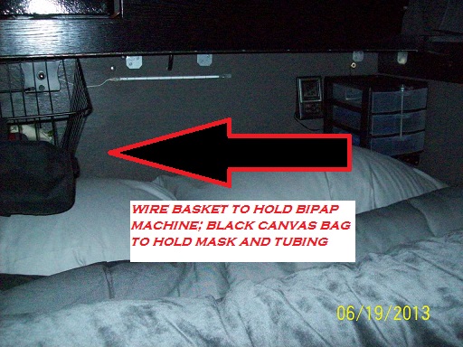

Part of the "specifications" given me by my wife, if she was "ever going to use the trailer", was a place for her BIPAP machine (I had called it CPAP for years, but was recently corrected on this matter).
BIPAP basket in cabin.JPG (150.6 KiB) Viewed 2515 times
I constructed the trailer with 2 power modes: an Optima Yellowtop battery (12vdc) to power 12v LED lights, computer case-fan-ventilators and car stereo, and a 12vdc-to-110vac 410watt inverter (to use in case all 110vac sources failed), and either park-sourced power or trailer-mounted 2500watt generator to power the 110vac LED lighting, A/C unit, heater, main ventilator fan, and BIPAP . If the park power or generator failed, then the battery alone would (thru the inverter) power the BIPAP and minimal 12vdc LED lighting, plus the computer fans for ventilation, thru a coupla nights in my worst case thinking. And, if worse became worst, all my vehicles have 400watt inverters, that could also power her BIPAP machine. She could sleep a night or two without the lights, fans, A/C, heat, or stereo, but I'd rather have her use the BIPAP in any case.
