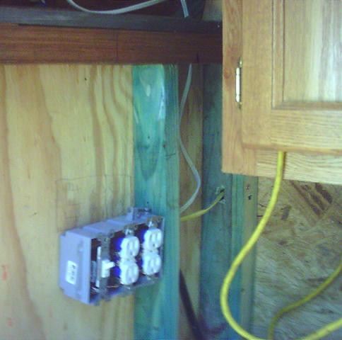

I used shallow versions of the blue plastic ones for all my 120v outlets - just safer and easier to work in, plus they provide a means of mounting outlets and plates that are standard and look good.
