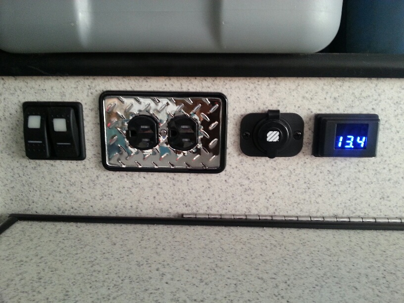

Postby teamredjeep » Thu Jul 24, 2014 8:21 pm
I already ordered a cheap surface mount volt meter before I posted here. This is how it turned out.
