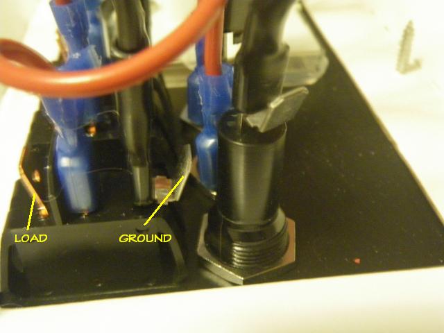

This picture isn't very clear, but there are two open spades. The higher one is to the positive side of the battery. I am guessing the lower one is for the ground to the battery and grounds for the lights and fan. Should this have a buss bar too? To connect all the grounds and then connect a single ground to the panel? Or is that complicating the actual wiring?

Going a bit out on limb here and say terminal on switch which appears to be bronze in color (in pic) is output of switch (panel) to device.... Also drawing shows the "load" off center terminal of switch but physical wiring of panel indicates "load" terminal is terminal furtherest away from fuse.... Time to connect panel to some power and bench test its functionality...
And it appears switch has a ground wired into lamp if switch is illuminated, also the terminal on switch closest to fuse (silver in pic) might possible be your circuits ground connection....BUT it may be easier to supply a simple ground bar external of panel...
Load-Ground
