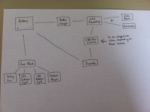

Dale M. wrote:For basics it looks like you have correct concepts on how it works for what you are tying to do.... Now you need to flesh it out with some actual details and values of breakers and such... Would like to see some sort of disconnect (cut over switch) between shore power and inverter power so you do not get back feed to receptacles though.... May also want to consider single unit that is inverter/converter that will charge battery and convert the DC to AC for receptacles...
Dale
TucsonWJ wrote:Is this what you are talking about? It looks like a good compact solution to multiple things as far as 12v fuse block, 110v power supply, battery charger and inverter. I'm just not sure if the output for the battery charger is to high, doesn't say if it is for a 12v system. I assume it is. What voltage can a AGM battery handle
http://www.wfcoelectronics.com/UI/Power ... e=3&pid=11
Do these have connections points for shore power? I assume they do just don't see anything in the literature explaining it. I'm sure that you just wire it up to a shore power receptacle, but just curious.
TucsonWJ wrote:Is there an inline fuse you would recommend?
