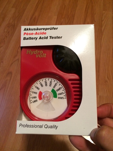

Postby abqlloyd » Mon Sep 15, 2014 7:55 pm
I received today from the above company. Prompt service and well packaged.

Postby MtnDon » Mon Sep 15, 2014 8:38 pm
Congrats. I do love mine. :thumbsup: :wine:
