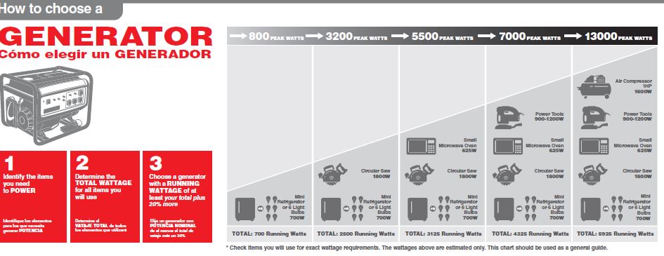

Loud and having to mix gas/oil to run it, all for 700 watts? If you need it as an emergency use only, to power some lights, OK. But I'd go bigger if I were you. Just my $.02. Here's the HF user guide for choosing a generator. It shows 700 watts (running) will power 6 lights or a mini fridge or a small microwave...I'm not sure if it is enough for a hot plate or a Mr.Coffee ( whoops, showing my age... I meant a Keurig).

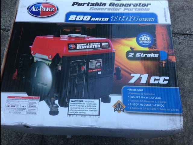

My generator arrived today- it's another Chinese clone of the Yamaha ET950 2 stroke, that the HF one is based on. I looked high and low for this one- it has a 71cc engine, HF is 63cc. It is rated 800/1000 watts , HF is 700/900 and it has an 12vdc 8.3 amp battery charging outlet, which the HF do not ( that's a big extra). In addition the gas tank is 1.2 gallons, which is bigger than the HF one. The extra engine power and generator output might be just enough to get by. The goal is to run a 5000 btu A/C and run a 700 watt microwave. Obviously, not at the same time.
The generator is an All-Power APG-3004A 1000 watt model- $89.95.(ebay) I wanted a cheap generator to deter theft and it's also fairly lightweight, which is an all important consideration. I'll post the results later on my Weekender-XL build topic.
added: yes, it does run my Haier 5000 btu A/C with no engine strain.
