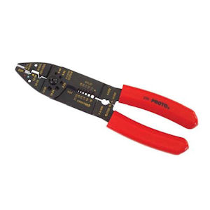

For crimpers... I recommend those that are ratchet type with replaceable jaws to accommodate type and size of connector (Insulated or non insulated).... They tend to put a more precise crimps that hold better (not specifically recommending one below, image is for example only)...

You are basically correct about the problem is the way people do the connection... Unfortunately in the video you provided, there is misinformation..... It demonstrates using a T&B or GB brand (or equivilant ) indenter crimper (about $20-$25) on a insulated connector... This is wrong... A indenter style crimper as in video is only used with NON INSULTED connectors, but video is correct about where seam of connector is placed....
The type of crimper I dislike and encourage people to stay from are these that cost from $5-$10 at local FLAPS or Big Box store...
The ratcheting style crimpers with interchangeable dies was "minimum requirement" for doing power cable and wire connections in telephone industry where spent almost 40 years doing power cable/wire connections... The reason for ratcheting crimpers is they can compress connection tighter then using hand crimp pliers for better grasp of wire and to make a "gas tight" connections... A gas tight connection is a connection where the connector is compressed on wire enough to keep oxygen out of connection helping to prevent corrosion...
Notice non-indenter dies in this pic for connectors with insulated barrels...
Notice Indenter dies for connectors with out insulation...
