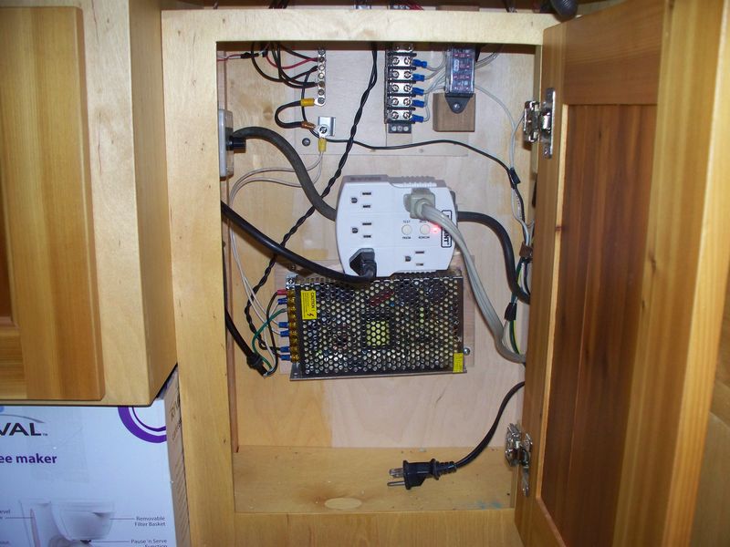

Ok I got this today only no wiring diagram...SUPERNIGHTâ„¢ DC 12V 20A Regulated Switching Power Supply AC 110-240V
(This Power Supply Unit "DOES NOT" come with installation instruction, wiring cable, on/off switch, or screws.
Professional installation of qualified electrician is highly recommended.)
Not being an elec. to the left is the AC hook up , What is the, L N, which is + and - ?
And what is the emblem just to the right of that, ground?
I understand there are 3 seprate 12 volt out puts to the right of that, correct...
And all the way to the right it looks like something a tinny philips head would fit in to rotate....
On the box it says output 5V,12V,24V,36V,48V DC

I believe that the L is for Line, that is the black wire in the 120 volt AC three wire cable.
The N is Neutral, the white wire.
The symbol is for ground, the green wire.
Yes, the next six connections are the three circuits that you want to provide 12v power to.

L = Live = Black AC Wire
N = Neutral = White AC Wire
Symbol = AC Ground
COM = Common = DC Ground (-)
+V = Positive Voltage = DC Voltage (+)
Adjustable Pot = Adjust output voltage to desired DC Voltage i.e. 5v, 12v, etc. It will apply across all outputs, they can not be set separately.

I haven't used this type, but it looks to be a "static" output or simple power supply. For charging a battery, you would need to have a system which "steps" the voltage in increments to bring it up to full charge, then monitor for a trickle charge to maintain voltage. While it might be able to provide voltage for a full charge, it wouldn't be smart enough to "ramp down" when a full charge is established, and could then cook the battery if left plugged in for too long.

It might not even do a good charge as a 12 volt battery needs a voltage of around 14.4 volts to recharge in a reasonable time.
This is a simple power supply, a battery substitute. Not a charger.

Mt Don and Noseoil answered the question correctly. As Don says, this is a substitute for a battery, not a charger for one. I use one of these in my standy trailer to power 12 VDC accessories because the standy has no battery or permanent 12 VDC wiring.

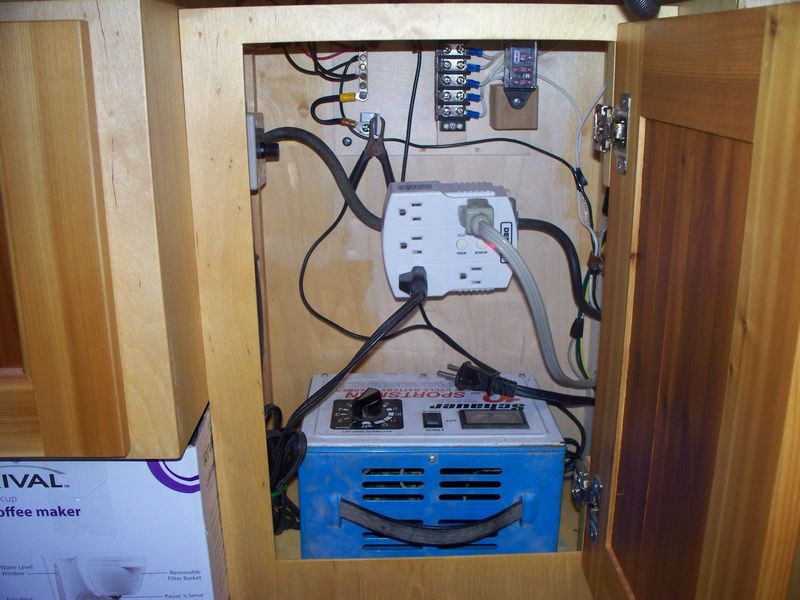

Well, I changed out my deep cycle battery charger. I have had it for probably 20 years, used for trolling motor batteries....
