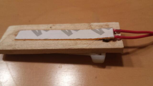

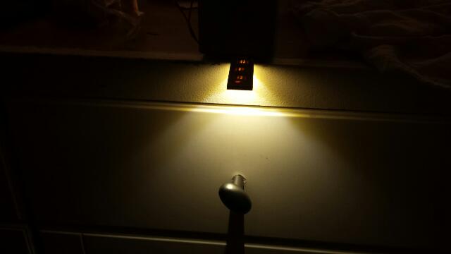

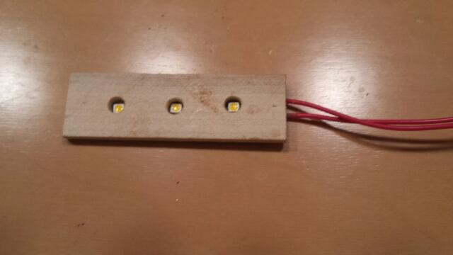

Here is my under shelf mini light, about two and a half inches long, total cost was four cents

Postby Graniterich » Fri Nov 21, 2014 11:47 am
Mike46, they are definitely bright enough, although they are coiled like an old reel to reel tape, about quarter inch wide. Bending that way wouldn't be easily done. Any application that allows for straight lines would be best. In my last picture I used three, you could have nine (three strips of three) in a 2.5 x 2.5 inch area. EBay user was newyork_lin. Bought some green and red ones last night for the holidays with dimmer remote for eleven dollars
