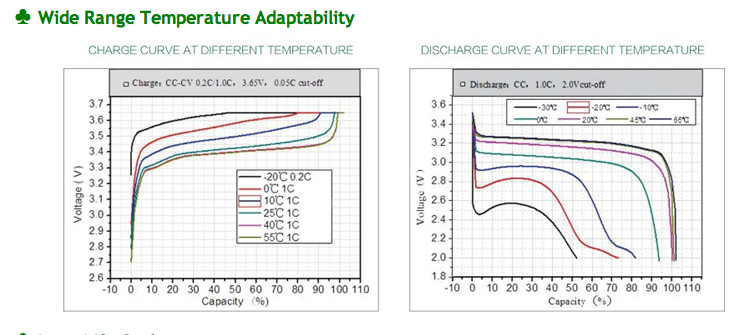

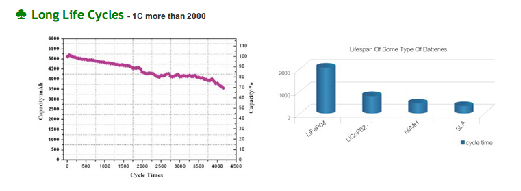

I'm thinking of putting together a deal for lithium batteries 12v 100 AH packs, these are equal to 200-300 ah flooded batteries, they would be able to do 2000 cycles and still maintain 80% or better storage.after that you could get another 2000 cycles but batteries then might only store 65% the batterys operate at -40F up to 145 F , however it is not recommended to charge them if if the battery is below freezing. current street price for a set with BMS is approx $850 , plus tax and shipping.

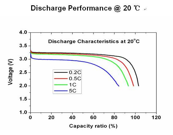

Most of you are not gonna drain the battery at more then 0.5 to 0.2C so the volts stay at 13.3 until 85-95% empty
this is the best because a reg flooded battery drops to 11 volts like a rock.

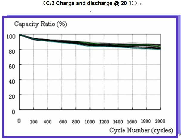

After 2000 cycles at 80% DOD...the battery still would hold 80% charge for another 2000 cycles,
then it would hold 65% charge for 2,000 more cycles. you would never touch that with a flooded $80 T105 golf cart battery.
Hi guys , I say a set of lithium because to get 12 volts , you actually need 4 cells each which is called a 3.2 volt LifeP04 cell. The battery if fully charged would peak out at 14.5 volts. If you remove about 5% it mostly sits at 13.3 volts until you remove about 80% of the voltage or charge. From there it quickly drops to 10 volts , where you need to stop as you are now 90- 95% DOD.

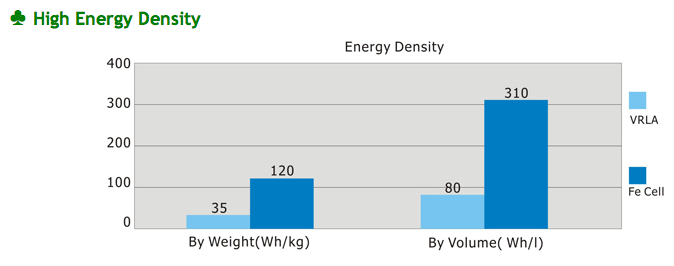

The weight of the lithium is actually 25% of the flooded as 100 ah lithium is really equal to 200 ah flooded.
