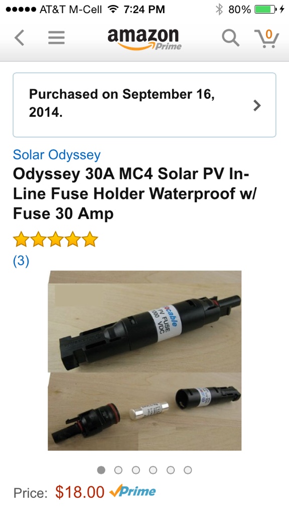

I have inline fuses from panels to charge control - they are MC4 inline fuse holders. They can also be incorporated into the system between battery and CC.

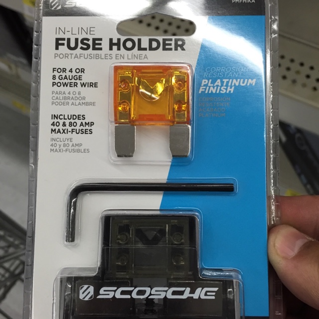

I ran across these on a solar forum and they are another cheap option.
$7 at Walmart. Fuses are fast-acting.

I bought these in September.
