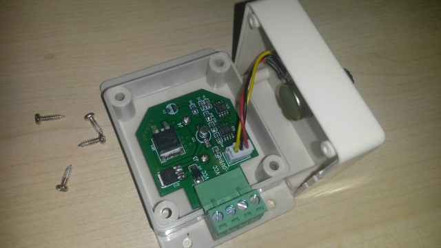

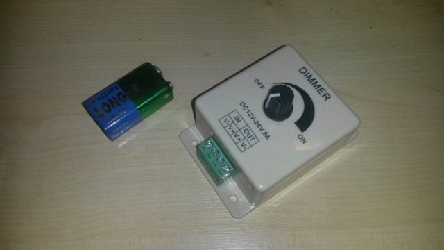

Postby teddy » Sat Dec 27, 2014 9:50 am
I've bought a couple of these, combined with simple automotive switches.
The housing is quite large, but the internal circuit is not, and the variable resistor is on a seperate board, so its easy to place the knob somewhere close and lenghten the wires to te circuit to be placed somewhere remote.

Postby Wobbly Wheels » Sun Dec 28, 2014 12:06 am
teddy wrote:I've bought a couple of these...
Cool - I was looking at getting two of them. Do you think they can honestly handle the 8A rating or is that just a bit o' the old eBay BS ?

Postby teddy » Sun Dec 28, 2014 7:11 am
Wobbly Wheels wrote:Do you think they can honestly handle the 8A rating or is that just a bit o' the old eBay BS ?
Its chinese stuff, my rule of thumb is to halve the ratings. That said, the circuit board doesnt look too bad, it might do 8 amps, but 8 amps of LEDs is quite a lot.
lrrowe wrote:I did see these, but did not like the size and mounting issues (to me at least). Are you suggesting you can remove the knob and board from the box and use them in one's own drsign? If so, do you have any photos of them in your project?
I havent used them yet, just unpacked one to see if it works, and it does. The knob is just held on with a small nut, so easy to place almost anywhere, and the external connector is a seperate piece aswel, so you could do without it, and just solder the wires on. If you need acurate measurements or something, please do tell.

Postby lrrowe » Sun Dec 28, 2014 8:25 am
teddy,
This is perfect. Thank you for the photos. Yes it looks very easy to work with.
