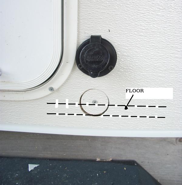

Postby bobhenry » Thu Feb 26, 2015 7:21 am
Being the king of cheap..........
here is up close on Rip Van Winkle. I have done all 4 of my trailers like this with only one problem.
ICE! Yep ice went to a shivaree and the ice and slush kept tripping the breaker at the park.
Here is Chubby plugged in.
Oh if you do go with the marinco mounted plug, check for obstructions behind before drilling :cry:

Postby 39Ratrod » Wed Apr 08, 2015 6:56 pm
Ouch! That sucks!

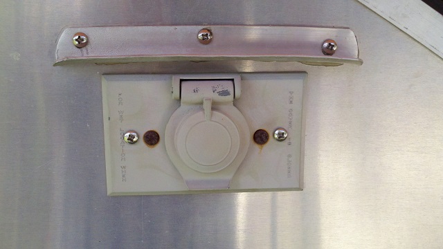

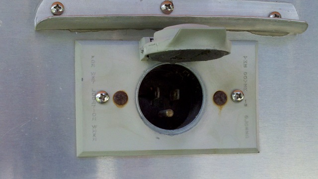

Postby Nobody » Thu Apr 09, 2015 9:48 am
Wobbly Wheels wrote:There is an RV fitting that's just a 15A 3 prong male plug in a waterproof wall plate. Even though I have access to marine stuff through work, this will be fine for a trailer along with a 50', 12ga extension cord.
It was in a 1977 camper I scrapped out for the appliances and windows
When I built my TD in 2006 I used pretty near the same 'inlet' from Leviton. As said, it isn't totally waterproof but mine is mounted high on the street side wall & has worked great for over 8 years & lotsa miles. The rusted screw heads shown in the pix are from the factory & hold the thing together. Might be a good idea to either change them to stainless or spray the entire inlet with a good weatherproof/resistant clear urethane before installation... Available locally (for me) & cost little.
