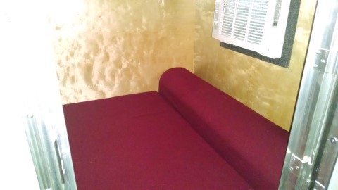

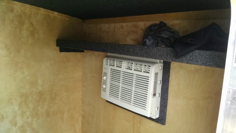

Postby Steve W » Thu Apr 09, 2015 11:02 am
I didn't do this build, it was manufactured for me. But as you can see they install small 5,000 btu ACs in the front area wall. It's pretty quiet so for now I am putting my full size trifold bed with the head under it. I like just sitting in the doorway and swinging into the bed. Easier than crawling in on all fours. And....... I don't hit my head that way :?
My bed under it
IMG_20150407_192637781 (Mobile).jpg (165.94 KiB) Viewed 1977 times
Inside ac with shelf build on top
IMG_20150407_140108924 (Mobile).jpg (169.15 KiB) Viewed 1977 times
