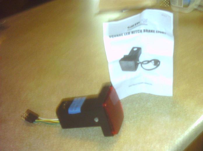

Postby noseoil » Tue Apr 07, 2015 7:28 am
OK Bob, I think I got it! Found a converter at e-trailer that should work. Not too spendy & easier than re-inventing the wheel.
https://www.etrailer.com/Accessories-an ... 18158.html

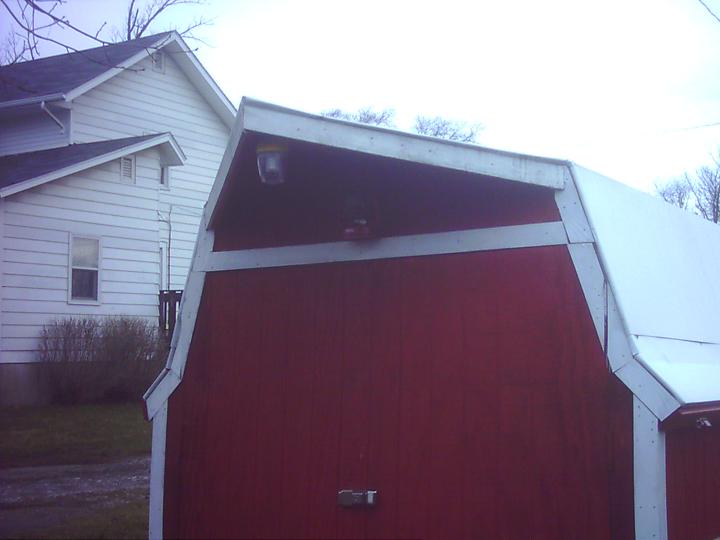

Postby bobhenry » Tue Apr 07, 2015 8:03 am
Here is the one I reinvented to act as a 3rd brake lite for the barn.
Thanks to Bruce's donation :applause:
