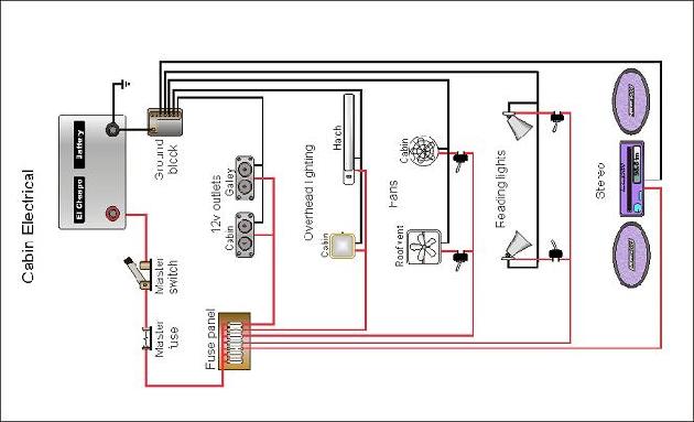

I used Joanne's pictorial schematic to help me understand the DC side of my build.....

The pic posted by bobhenry is nice, but you might want to add a circuit for exterior "porch lights" or even tie into the trailer's running lights, so you can find easily find your trailer after visiting the restroom at night.
Blue Sea make a nice 12VDC fuse block with + and - busses.
https://www.bluesea.com/products/5031/S ... gative_Bus
14/2 wire will work for all your DC runs will work. 14/4 trailer wire will also work and is super easy to get, but you don't get "black and red" color coding. 14 gauge will take up to 15A, so fuse everything @ 15A or less with 14 gauge. Use automotive wire not romex for DC runs.
http://www.waytekwire.com/products/1465/Trailer-Cable/
Missing from the picture is a AC to DC converter/charger. Also for very simple AC, you might consider mounting a power strip or two plus an extension cord to shore power. the DC converter could plug into the power strip in the galley, as well as the interior power strip. Then it's just a matter of plugging the galley power strip into the extension cord and run the extention cord to shore power. Make sure the power strip is the kind with a circuit breaker... and I would FULLY recommend that the power strip is protected with a GCFI.
The cooler, depending on the size will probably drain the battery fairly quickly, the Igloo Iceless 28 draws ~75 Watts, doesn't have a thermostat, so it runs and runs. That, along with heating, cooling, or electric blankets are best used with shore power.
A group 24 battery will give you about 80 Amp*hours. 12V*80Ah=960 Watt*hours... 960 Watt*hours/75 watts for the cooler = 12.8 hours, so you would need four batteries to last two days... but you're probably not going to put four batteries in your trailer.
