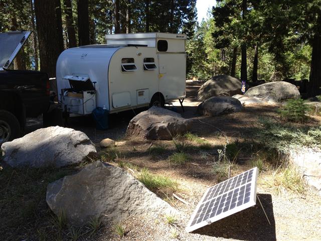

Your fridge looks like a rebadged Waeco; our Waeco uses around 1 amp-hr on average when set to 40F in 85F weather. I have no problem keeping up with our fridge and cell phones with an 80 watt portable panel. That's assuming the sun shines every day and you're not camped too far in the shade. :)

I have a 100 w Renogy Solar suitcase that seems to keep battery charged when using my refrigerator running on gas and camper interior lights. I am hoping to install led replacements if they get here tomorrow. Real test will come this week when I boondock for five days. I did it for two days and it kept my battery up during the memorial day weekend. The problem I have is that the controler for the solar panel isn't supposed to be left out in the rain. seems dumb to me to build something designed to be outside and not to have it so it can be left out in the rain.

They're pretty proud of their 90W panel @ $430 $> . Have you considered making your own folding panel for a lot cheaper? It's pretty easy to do:
DIY Folding Panel
Here's some links to build your own 120W panel for less than half the price of the 90W.

I have a 50 watt Renogy panel, an 800 watt HF generator and my truck linking. For the most part, the panel runs the fridge (Haier 3 ft3 dorm unit with 2000 w centech inverter) without much problem. In the past, if I needed a quick boost, I'd just link up the truck to the trailer (my old travel trailer, not this one yet) and let the truck charge the battery (20amp does a lot fairly quickly). If away from everyone and in the daytime, if I need some quick power, I'll fire up the HF.
On this initial trip of Conch Fritter, we had the truck charging the trailer running the fridge at 29F with outside temps in the mid- 90s while driving. No problems at all, except the fridge was a bit too cold.
