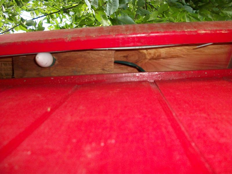

I use a plain Jane 5000 btu window shaker.
I use it maybe one or two outings a year so toting it around as a "installed" unit seemed a bit of a waste. I set the unit under the trailer in the shade and duct in ONLY the cold air output.
you are looking upward under the gambrel eves. I left a small slot open for venting in fresh air with a small fan of for the AC delivery.
Since cold air falls it has worked well to keep us comfortable while sleeping.
I do not attempt to recycle the cooled air to re cool. This has resulted in the unit NEVER freezing up and still gives us all the cool needed to be comfortable no matter the heat outside. I am not sure the BTU output of a 5000 btu unit if you are not drawing in the cool air to be re-cooled but I am sure it drops considerably. What we do get has been more than enough to be comfortable on the hottest of days.

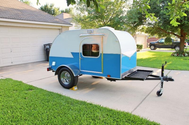

On our most recent build we installed the ac in the rear. It is covered by an aluminum lined box with baffling to direct the exhaust air down and back. There is ample air intake including an additional side vent. We camped at Belton Lake, TX on a 97 degree day and stayed very comfortable. we had no issues with using the ac. See photos in this album linked below:

I kind of like that! Does the A/C unit have its own fan that pushes the air out, or do you use another fan that's not shown? Does it short cycle in this configuration, or does it run good long cycles and dry out the cab pretty well? If so, this may be just what I'm looking for!

I built an airplane in my garage before I started building teardrops. I had to learn about using baffling to direct airflow to cool my engine. The baffling in the ac box fits tightly around the rear portion of the unit. The exhaust jets out the bottom without the use of any additional fan. We ran the unit continuously. My wife complained that I kept the trailer too cold. A 5000BTU air conditioner doesn't have to work very hard to keep a teardrop cool.
Dave and Jan Clay
