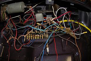

Postby bobhenry » Wed Jul 22, 2015 2:15 pm
While not exactly a tiny trailer wiring adventure I must admit you sir are an artist when it comes to correctly routing and forming the circuits. Any builder could take a lesson that a bit of care makes a wiring job , what ever it is, go so much smoother.

Postby Dale M. » Fri Jul 24, 2015 5:55 pm
bobhenry wrote:While not exactly a tiny trailer wiring adventure I must admit you sir are an artist when it comes to correctly routing and forming the circuits. Any builder could take a lesson that a bit of care makes a wiring job , what ever it is, go so much smoother.
Why is that so typical of a Volkswagen...
