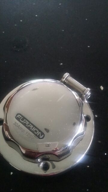

The fancy new furion gives the marinco a run for its money.
Here they are nearly 300 bucks but i got mine on amazon for about 160 australian.
Pretty indulgent but it looks awsum,worst thing was i stripped all the guts out of it and fitted an aussie 15 amp male socket in it for another 30.
dales133
