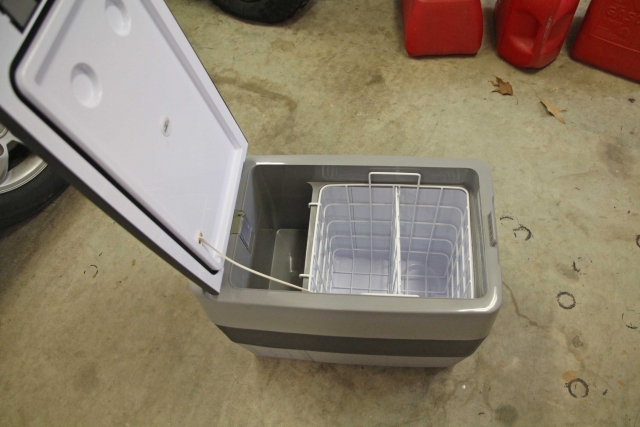

Postby lrrowe » Tue Feb 23, 2016 1:58 pm
lrrowe wrote:I had a 3 cf Frigidaire small refrigerator in my CT this past spring and summer. It did a great job on 120. But it just stopped working this summer while sitting in the driveway. Did the boincing around hurt it? Not sure. But I was not on the road that much.
For it's replacement, I did all the typial research for the other types, regular ice cooler (7 day Extreme-have one), 12v Truck type and 12v top loading type and similar 120 v units.
They all have pros and cons and will appeal/not appeal to others based on their individual likes and wants.
I finally decided to go with a 12v top loading one. They are pricey yes, but I think they offer me the best service and flexibility. The one I have settled on will also freeze bottles which I can use in an exterior ice cooler. And I can remove it to travel to events where the trailer will not be with me. I have tested it to prove my next thought, but I believe I can put more into a top loading unit then I can in a door unit.
http://truckfridge.com/store/page6.html
I like the large one, TF51
My Truckfridge (actually it was and Indel unit from Truckfridge) came in last week.
I got a TF51 which cost about $595 (inc shipping) online from Truckfridge for $450 with shipping included.
I am anxious to try it out.
Bob

Postby jonw » Tue Feb 23, 2016 4:28 pm
I've got a TB41 Truckfridge/Indel B - the mid-size 40 litre model from http://www.equipt1.com. Looks the same as in the picture above only it's not quite as deep.
It's efficient, works well, is quiet, and it's a wonderful thing not having to deal with getting and draining ice continually.
Not cheap, but well worth it in my book.
